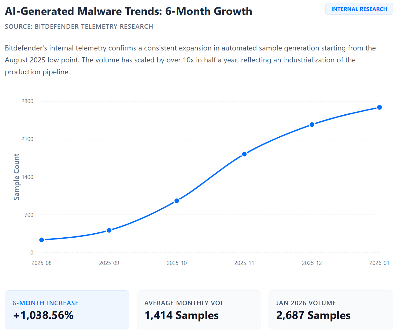

The current threat landscape validates some of our AI predictions from two years ago. We noted that people should not imagine a complex binary skillfully maneuvering through a network to pinpoint vulnerabilities, but rather "a code with minor customizations, crafted in a language of your preference."
Contrary to popular belief, gaining access to functional malware source code is trivial. GitHub Repositories such as theZoo or vx-underground collections provide access to thousands of live samples, proofs-of-concept, and historical source files for researchers and adversaries alike. Because LLMs are trained on these vast, public datasets, they have essentially "read" and internalized thousands of distinct implementations of malicious logic, enabling them to reconstruct and vary these routines with minimal prompting.
But a critical assessment of this capability reveals a nuanced reality. While LLMs are highly proficient at pattern recognition and logic mapping, they do not possess a true understanding of security context. They function as engines that retrieve and reorganize existing patterns rather than inventing new ones. Consequently, the "reconstruction" of malware is often a process of assembling known fragments. This leads to what we identify as the "Mediocre Mass".
apt36-image3
This chart shows the total number of unique AI-generated malware samples found in our telemetry over the last six months (not limited to APT36). We’re planning to publish a more detailed analysis as we collect more data.
The vibe-coded samples in this investigation are not technical masterpieces. They are often generic, inconsistent, and error-prone. While we assigned names to the malware to help track individual samples, the overall relatively low development quality makes them arguably not worth naming. Instead, it would be more accurate to label this kind of malware as "vibeware". We have reached a similar conclusion as the recent report from Google's GTIG team, which noted that they have "not yet observed APT or information operations (IO) actors achieving breakthrough capabilities that fundamentally alter the threat landscape."
While this malware lacks true technical innovation, it would be a mistake to underestimate the risk it poses. The threat lies in the industrialization of these attacks. We are seeing a convergence of two trends that have been developing for some time: the adoption of exotic, niche programming languages, and the abuse of trusted services to hide in legitimate network traffic. This combination allows even mediocre code to achieve high operational success by simply overwhelming standard defensive telemetry.

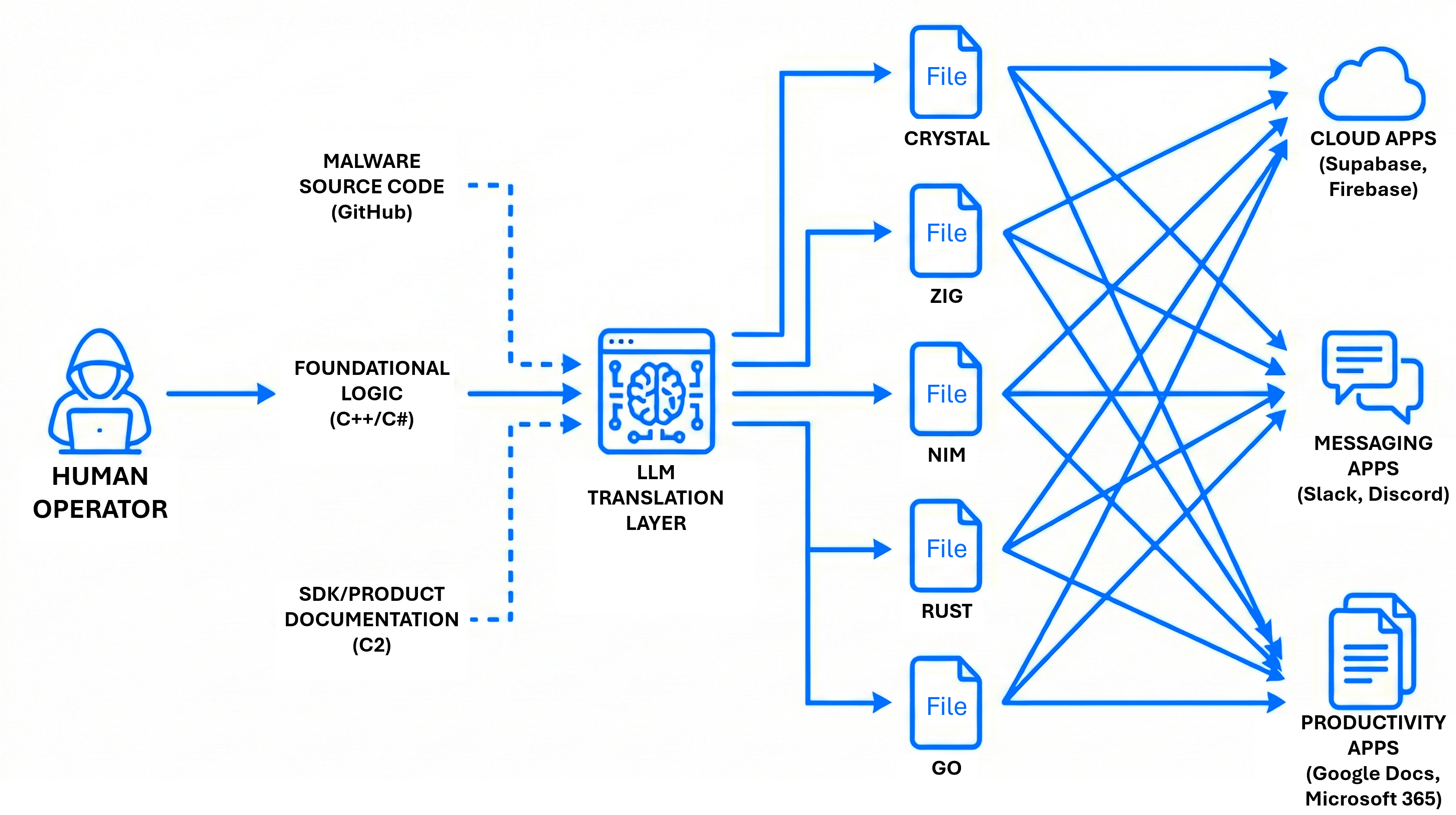

Malware Polyglots
While LLMs are not currently architecting novel attack methodologies, their influence is distinctly visible in enabling the rise of malware polyglots. Historically, pivoting from a well-known framework like .NET or C++ to a less common language required significant time and effort. Today, AI-assisted development has collapsed this barrier, allowing actors with foundational logic skills to cycle through different languages with minimal friction.
Most detection engines rely on signatures and behavioral patterns heavily tuned for common languages like C# or C++ - the way these languages manage memory, handle system calls, or structure their runtime. When a threat actor uses an "exotic" language, they essentially reset the detection baseline. Furthermore, many of these modern languages, such as Rust, Go, and Zig, are inherently OS-agnostic, leading to a growing trend where malware is developed to target multiple operating systems simultaneously with the same code base.
In this research, we identified several different languages:
  • Crystal and Zig: These are niche enough to lack established behavioral signatures in many EDR solutions. For example, Warcode and CrystalShell utilize Crystal to provide high performance without the common signatures associated with C++ or C#.
  • Nim: This serves as a stealthy wrapper for legacy payloads. Because it compiles to C or C++ but uses a unique runtime, it often appears as an "unknown" rather than a "malicious" binary to simple scanners.
  • Rust and Go: These are used for "noisy" operations like file harvesting and exfiltration. Their built-in memory safety and performance ensure that the malware remains stable during intensive tasks, preventing crashes that might otherwise alert a system administrator.

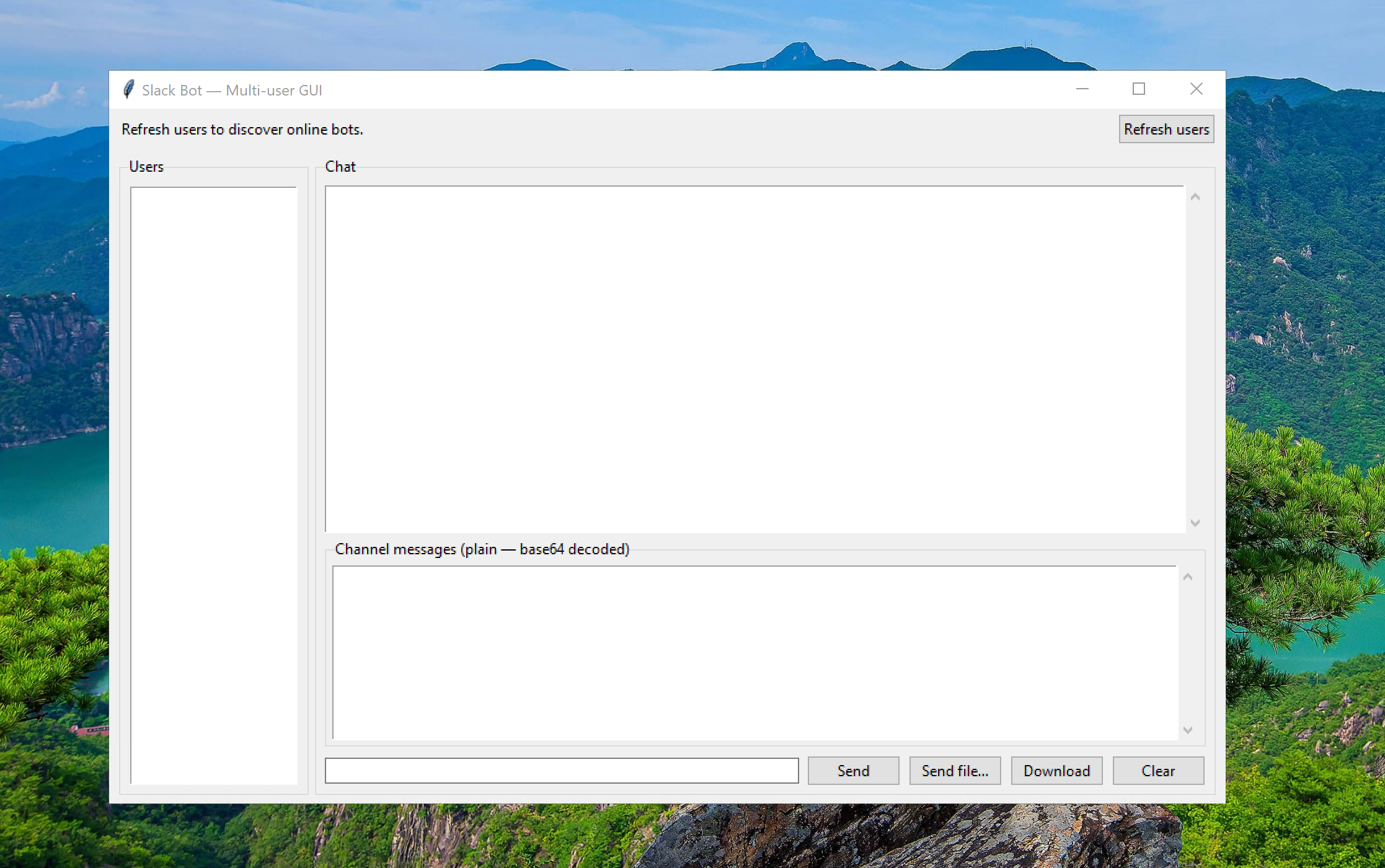

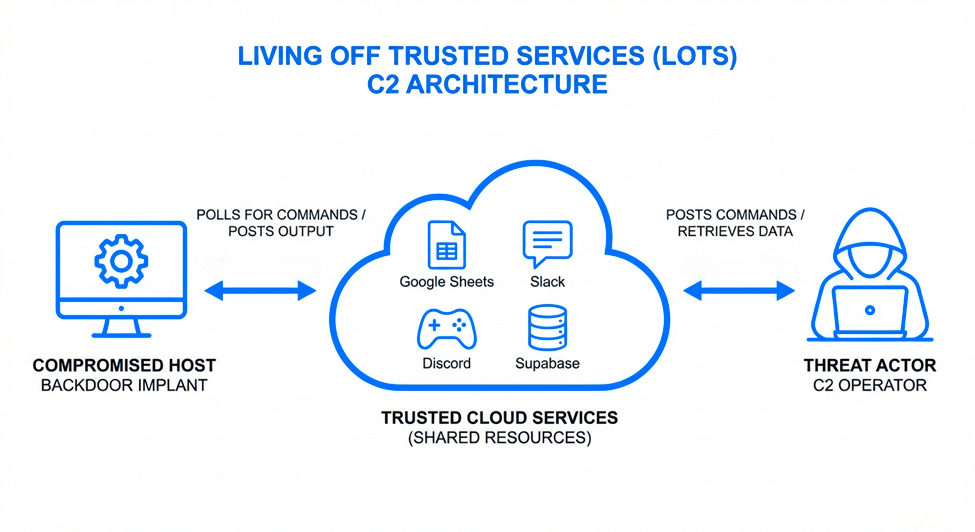

C2 via Living Off Trusted Services (C2)
While language diversification complicates binary detections, malware can still be identified by its Tactics, Techniques, and Procedures (TTPs). While the binary might look different, its behavior remains its most durable identifier. To counter this, threat actors are increasingly adopting a "Living Off" philosophy to stay undetected by blending into the target environment's noise. This strategy is standard practice among sophisticated threat actors, and our research indicates that up to 84% of modern cyberattacks now use legitimate, pre-installed tools.
Historically, the "Living Off" concept primarily referred to Living Off the Land Binaries (LOLBins). However, this philosophy is not limited to local binaries. We are observing a significant trend towards Living Off Trusted Services (LOTS). Our research has identified threat actors using Google Sheets to store dynamic instructions for malware, leveraging cloud databases like Firebase or Supabase for storing metadata and credentials, and utilizing Slack or Discord messages to send real-time instructions or retrieve harvested data.
apt36-image4
This image details some of the ways threat actors are leveraging trusted services.
LLMs are exceptionally well-suited for implementing LOTS, as legitimate services are extensively documented with vast quantities of legitimate code examples and SDKs. This abundance of training data allows an LLM to generate robust, functional integration code for complex APIs with high reliability.
For a vibe-coding actor, this is a win-win scenario. They can prompt an AI to produce a stable, C2-ready client using a trusted service API without needing to build their own suspicious infrastructure or understand the technical nuances of the underlying protocol.

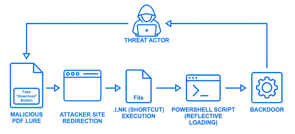

Initial access is believed to occur through malicious emails. We have identified evidence of shortcut files (.LNK) bundled within ZIP archives or ISO images, which are likely delivered as email attachments. These archives act as containers to bypass simple file-extension filters on mail gateways.
One notable technique uses a PDF file as a visual lure. The document contains a high-quality image of a resume with a large, prominent "Download Document" button overlaid. Once a user clicks this button, they are redirected to an attacker-controlled website, which likely triggers an automatic download of an archive containing the previously mentioned shortcut files. This multi-stage redirection adds a layer of social engineering, as the initial PDF appears benign to many scanners while the malicious payload is hosted externally.
apt36-image5
This image shows the threat actor using a PDF file as a visual lure.
The shortcut files, once executed by the victim, initiate the download and fileless execution of PowerShell scripts in memory. These scripts then download and execute the primary backdoor. Once the backdoor is active, the attackers transition to an interactive phase, connecting manually to the compromised host to conduct post-exploitation activities.
apt36-image6
The image above shows how the threat actor utilizes the malicious PDF to initiate the attack.

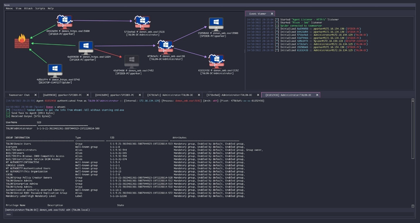

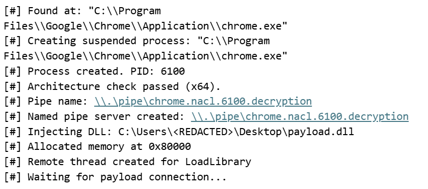

Warcode is a critical part of this fallback strategy. It is a custom shellcode loader written in Crystal language. We have observed the binary, warcode.exe, in common writable locations such as C:\Users\Public\AccountPictures and C:\Users\Public\Downloads. Telemetry shows this specific loader was in use prior to the current campaign, indicating it is a trusted component that the actor considers resilient.
The malware functions by reflectively loading a Havoc C2 agent directly into memory, which then establishes communication with the hardcoded infrastructure at 23[.]152[.]0[.]81.
apt36-image7
Havoc is a modern open-source post-exploitation framework designed for stealthy command and control. Source: Havoc’s GitHub Repository
This hybrid strategy ensures that their mission remains resilient. If the experimental tools are blocked or don’t function as intended, their reliable, human-audited tools provide a backup channel.

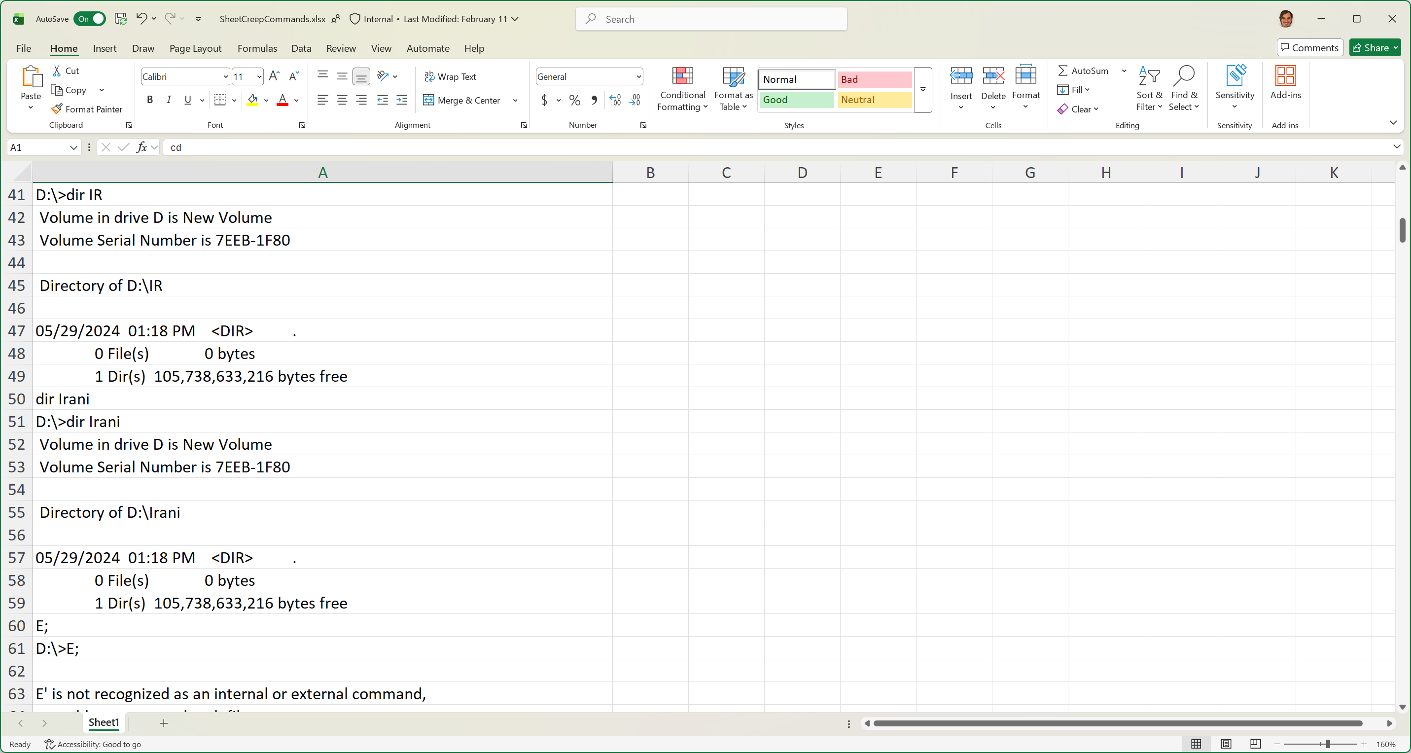

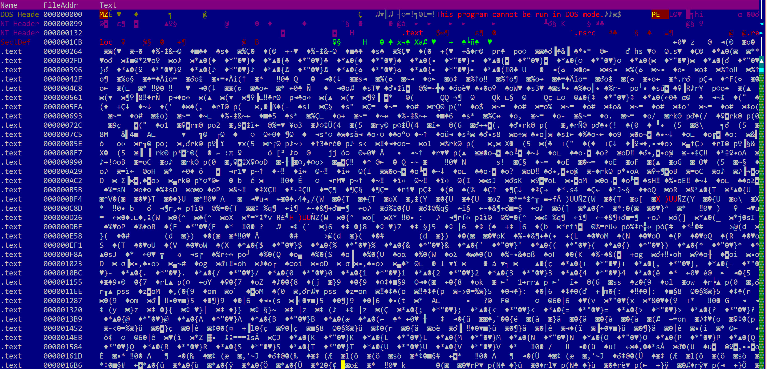

While the basic architecture of SheetCreep remains a C#-based backdoor utilizing Google Sheets for command retrieval, our investigation uncovered several new insights. The sample identified at the victim (compiled at 2025-10-28 09:58:46) used a simple file-detection bypass technique - the entire binary was written in reverse within the file. After mirroring the bytes from end to start, the file yields a valid MZ PE .NET assembly.
apt36-image8

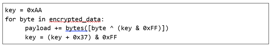

Typical executable files begin with the "MZ" header, represented by the Hex values 4D 5A. Static security scanners rely on this header to identify binary files for analysis. This signature is named after Mark Zbikowski, a lead architect of MS-DOS. Coincidentally, one of the writers of this research shares these same initials.
The primary module, named GServices.dll, implements a Google Sheets-based C2 technique similar to publicly available tools like google_RAT or GC2-sheet. This logic transforms a Google Drive spreadsheet into a bidirectional C2 hub where instructions and outputs are exchanged as cell data. The backdoor routine follows a specific cryptographic flow:
  1. It polls a specific spreadsheet for new entries.
  2. It fetches and decrypts issued commands using Base64 followed by DES in ECB mode.
  3. It executes the decrypted command on the host.
  4. It re-encrypts the response and transmits it back to the spreadsheet using the Google Drive API.
apt36-image9
Decrypted command sequence within the malicious C2 spreadsheet. The commands are presented here in their unencrypted state. Notice the "E;" typo as evidence of a manual, hands-on operation.

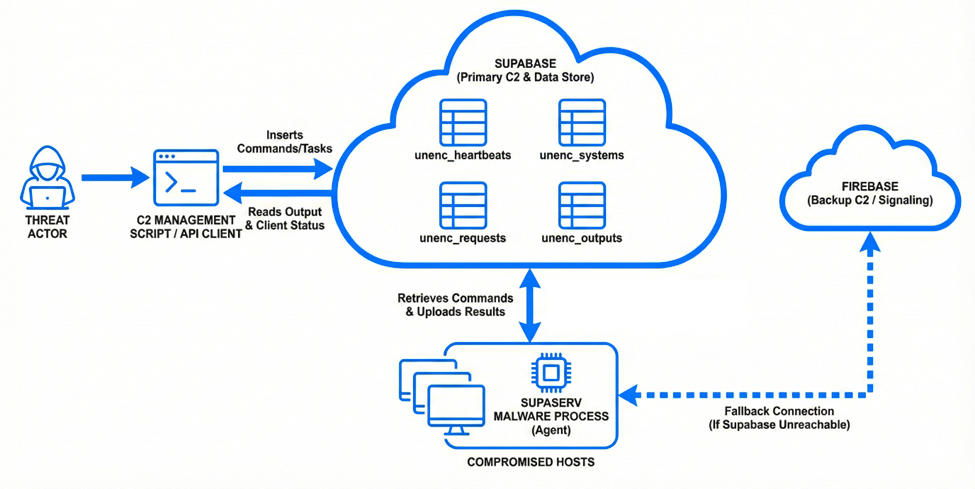

SupaServ
SupaServ is a backdoor written in Rust that exemplifies the transition from simple scripted routines to more complex, native implementations. The presence of Unicode emojis in the code, such as '🌐 Browser simulation enabled', '🔀 Random user agents', and ' Completed cycle', is a hallmark of AI-assisted or AI-generated development.
SupaServ maintains its presence on the host by using the ITaskService COM interface to create scheduled tasks that trigger at a user logon. We have detected task names such as DateAndTimeService and personalServiceTask.
The malware establishes a primary communication channel via the Supabase platform, with a Firebase backup. Supabase and Firebase are cloud platforms that provide managed database services to developers. Firebase is a proprietary Google service, whereas Supabase is an open-source alternative based on PostgreSQL, and traffic to these domains is often trusted by default in enterprise environments. Authentication tokens for both services are hardcoded directly within the binary.
Command and control tasks are managed through four database tables:
apt36-image10
SupaServ implements two primary operations, open <path> and download <url> <destination path>, where the path and URL parameters are provided in the request from the C2. Analysis reveals two distinct variations in how these operations are handled.

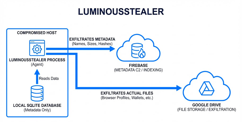

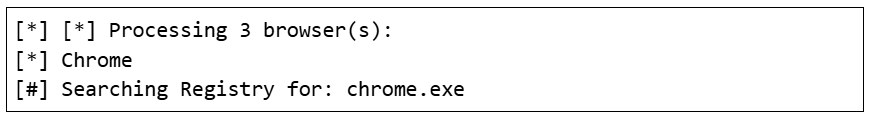

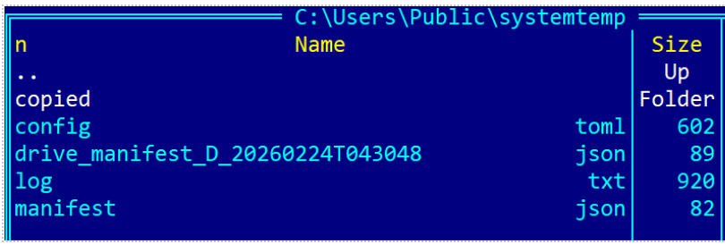

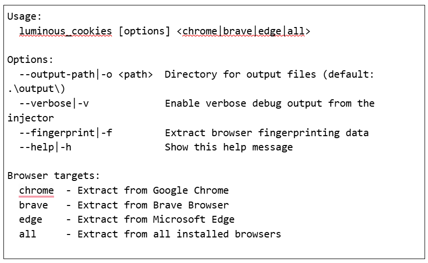

LuminousStealer
LuminousStealer is a recently identified Rust-based infostealer (compiled 2026-01-07). Like SupaServ, it is a vibe-coded tool containing multiple emoji-enriched logging strings:
  • 📤 Sent folder metadata to Firebase
  • 📊 Enumerating top-level folders and files in drive
  • Folders stored in DB
  • 📤 Sending folders to Firebase...
  • 📭 No top-level files in drive
  • 💿 Enumerating drive
Persistence is maintained through a scheduled task created with high privileges named LuminousBackupService.
Unlike simpler harvesters, LuminousStealer implements more robust local staging using an SQLite database (%LOCALAPPDATA%\backup_database\backup.db) to manage five internal tables:
  • files: Catalog of all identified files.
  • sessions: Tracking for active exfiltration sessions.
  • folders: Directory structure metadata.
  • command_queue: Tasks received from the C2.
  • upload_queue: Files staged and waiting for cloud exfiltration.
The malware performs recursive directory scans across all available drives, looking for files with the following extensions: .txt, .docx, .pdf, .png, .jpg, .xlsx, .pptx, .zip, .rar, .doc, and .xls. To minimize its operational footprint, LuminousStealer stores this metadata in the local SQLite database. By comparing scan results against existing records (diffing), it ensures that only new or modified files are cataloged for exfiltration.
For actual exfiltration, LuminousStealer uses split-strategy of dividing metadata and content of files. All file metadata and catalog records from the SQLite database are uploaded to Firebase, while the actual file contents are queued and uploaded to Google Drive. Both Firebase and Google Drive are authenticated using Google OAuth.
apt36-image11

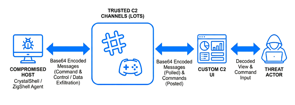

CrystalShell
CrystallShell is a backdoor developed in the Crystal language, designed for cross-platform deployments (Windows/Linux/macOS). The samples identified between late December 2025 and late January 2026 reveal improvements in C2 credential management, but also several notable implementation failures.
Most of the samples we’ve analyzed use Discord as the primary C2 channel, though a single variant was identified using Slack. The actor's method for securing the Discord bot tokens evolved across the samples.
  1. Initial Stage (Dec 2025): Tokens were hardcoded directly within the binary.
  2. Intermediate Stage: The malware started fetching tokens from a public, unauthenticated Firebase Realtime Database endpoint.
  3. Current Stage (Jan 2026): The most recent samples utilize Supabase with authentication enabled to retrieve C2 credentials.
The malware uses hardcoded Discord channel IDs for command and control and implements a rudimentary authorization check. It validates the Discord User ID of the sender. If a command originates from an unauthorized user, the bot responds with "You are not authorized."
All communications within the C2 channel are Base64-encoded to obscure the traffic from simple string-based filtering. Upon initialization, the agent announces its presence by posting a message in the format Users:<username>/<bot pid>.
All interactions between bots and operator follow the same command and response format:
  • Targeting: The protocol supports targeted execution using a <target> <command> syntax. The code accepts targeting strings in three formats, <host>/<username>/<pid>, <username>/<pid>, and <pid>, but the filtering routine specifically extracts and evaluates the <pid> filter. Commands issued without a target prefix are executed by all connected agents.
  • Command Format: Direct commands must be prefixed with a specific tag and Base64 encoded: ! en<base64(command)>

Commands issued through the Slack and Discord management interfaces show the operators performing a wide range of tasks, following a standard progression from initial discovery to final exfiltration. Messages related to CrystallShell (both Discord and Slack variants) and ZigShell started on 2025-12-08 and remain ongoing as of the time of writing this report.
  • Frequent use of curl, ipinfo, ipconfig, net view, and arp to map the network.
  • Regular listing of scheduled tasks/processes/directories.
  • Reliance on PowerShell for advanced tasks, mostly using iex (Invoke-Expression) to run code directly from remote servers and loading malicious .NET assemblies into memory. PowerShell was also used for capturing screenshots and recording audio.
  • Deployment of additional tools and malware, mostly hosted on the file-sharing service tmpfiles.org.
  • Systematic staging of sensitive data followed by exfiltration to attacker-controlled cloud storage.
Notably, we observed frequent command-line errors and malformed commands.

To automate the Base64 encoding and decoding process, attacker used a custom GUI wrapper. While we’ve been only able to locate this UI for ZigShell, we can safely assume that equivalent tool was developed for CrystalShell.

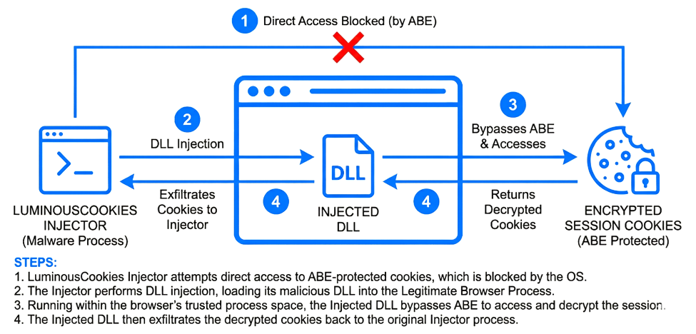

LuminousCookies is a specialized injector to exfiltrate cookies, passwords, and payment information from Chromium-based browsers, specifically targeting the bypass of App-Bound Encryption (ABE). Before we start with LuminousCookies analysis, it’s useful to look at ABE and how it’s being decrypted.
What is App-Bound Encryption (ABE)?
App-Bound Encryption is a defense-in-depth mechanism introduced in Chromium version 127 to secure sensitive assets like session cookies and stored credentials. Historically, these secrets were protected by the Windows Data Protection API (DPAPI), which only verified the identity of the user, which allowed any malicious process running with user privileges to decrypt the browser master key. ABE mitigates this by binding the encryption key to the cryptographic identity of the browser application itself. Decryption requests must be processed through a verified system service that confirms the request originates from a legitimate, signed browser binary. This shift forces attackers to move beyond simple file harvesting to more invasive techniques, such as process injection, to access the decrypted data.
ABE Decryptor Foundation
Under normal circumstances, only the signed browser binary is authorized to decrypt the app_bound_encrypted_key value. To bypass this restriction, an injector must force the browser to load a malicious DLL into its own memory space. Once inside, the DLL can retrieve sensitive data by masquerading as a legitimate part of the browser process. With this key, all stored browser secrets, including session cookies and passwords, can be decrypted using standard AES algorithms.
The public proof of concept xaitax/Chrome-App-Bound-Encryption-Decryption hosted on GitHub demonstrated how App-Bound Encryption can be bypassed without administrative privileges by subverting legitimate browser components. Analysis of the fleet revealed multiple variations of malicious DLLs and injectors, but all identified samples were based on this original research (or its forks). The predecessor to LuminousCookies was a standalone C++ utility directly compiled from modified versions of the public GitHub repositories. This version was typically delivered as a DLL for sideloading and was characterized by a visible forensic footprint, including clear-text logging in %TEMP%/chrome_decrypt.log and output folders such as output_dll_default. We have found various versions of both an injector and injected library.
apt36-image14
LuminousCookies Injector
LuminousCookies (named by threat actor) is a modernized injector written in Rust. Two analyzed samples show compile timestamps of 2026.01.07 08:06:04 and 2026.01.27 11:46:05. The samples contain the hardcoded build path C:\Users\kumar\, providing a direct link to the development environment used for SupaServ.
The tool utilizes a standard injection method to deploy its payload into chrome.exe, brave.exe, or edge.exe:
  1. Creating a suspended browser process.
  2. Using VirtualAllocEx and WriteProcessMemory to write the path of payload.dll into the target process memory.
  3. Resolving the address of LoadLibrary within kernel32.dll.
  4. Using CreateRemoteThread to call LoadLibrary, forcing the browser process to load the malicious payload.
The malware includes a help menu:
 After execution, the LuminousCookies injector first attempts to locate and load a file named payload.dll from its current working directory. The tool then scans the system to identify active target processes for Google Chrome, Microsoft Edge, or Brave. Once a target process is found, the injector initiates the LoadLibrary injection sequence to force the browser to load the payload. For data transfer, the injector creates a named communication pipe and enters a wait state until it receives a completion signal from the injected decryptor module.
A technical conflict exists between the known ABE decryptor DLLs and the LuminousCookies injector. Standard ABE decryptor DLLs expect a communication pipe name to be passed as a parameter to DllMain, typically accomplished via process hollowing. However, the LoadLibrary injection method used by LuminousCookies does not support passing arguments to the entry point. This suggests the existence of a modified variant of the payload.dll that likely contains hardcoded pipe names, which we were unable to obtain.
BackupSpy
BackupSpy is a Rust-based utility (compiled 2026-01-12) designed to monitor the local file system and external media for high-value data. Internally identified by the string "BACKGROUND WATCHER STARTED - VERSION 2", this tool functions as a specialized collector that stages data for exfiltration by other components in the suite, storing everything in a single location C:\Users\Public\systemTemp.
BackupSpy uses a hardcoded custom configuration stored at C:\Users\Public\systemTemp\config.toml. If the configuration file is not found, it drops a default version. The default configuration includes an extension whitelist (16 file types) and a 50MB maximum file size threshold.
# enable_copy = true (by default) : set to false manually if you don't want copying
enable_copy = true
# copy_destination : where files will be copied when enable_copy = true
copy_destination = "C:\Users\Public\systemTemp\copied"
# Extension whitelist: only files with these extensions will be considered for copying/manifest
allowed_extensions = ["txt","md","pdf","doc","docx","xls","xlsx","csv","json","xml","html","htm","jpg","jpeg","png","ppt","pptx"]
# max_copy_size_bytes : any file larger than this will be skipped during copy (safety)
max_copy_size_bytes = 52428800
BackupSpy generates a detailed manifests of exfiltrated files in JSON format (manifest.json and drive_manifest_<drive>_%Y%m%dT%H%M%S .json). The tool also maintains an operation log at C:\Users\Public\systemTemp\log.txt. This log records scan starts, file matches, and errors.
Manifest files include the following attributes:
  • manifest.json
    • tracked_files
      • path
      • size
      • filename
      • last_modified
  • drive_manifest.json
    • drive
    • detected_at
    • files
      • path
      • size
ZigLoader
ZigLoader is a specialized loader written in the Zig programming language. Its primary function is the decryption and execution of arbitrary shellcode in memory. The analyzed sample (c0218ece73d9046e25293fbef71bc70c) shows signs of active development and anti-forensic techniques, including timestomping the PE header’s timestamp to date 1981-07-24 18:17:51. In the analyzed sample, the shellcode only executes calc.exe, indicating that ZigLoader is likely a proof-of-concept project.
ZigLoader uses a rolling XOR scheme to decrypt its 368-byte internal payload. The routine starts with a base key (0xAA) that is modified after processing each byte.
The decrypted output is a Base64 string that, once decoded, contains x64 shellcode. This shellcode does not call Windows APIs directly by name - instead, it uses a custom hashing algorithm to resolve function addresses at runtime.
Identified API Hashes:
  • 0x876F8B31: kernel32.dll!WinExec
  • 0x9DBD95A6: kernel32.dll!GetVersion
  • 0x56A2B5F0: kernel32.dll!ExitProcess
  • 0x6F721347: ntdll.dll!RtlExitUserThread
The loader leverages low-level system calls for memory manipulation, including NtAllocateVirtualMemory and NtFreeVirtualMemory, to stage the shellcode before execution via CreateThread.

2. Audit and Control Trusted Cloud Services (LOTS)
The reliance on Discord, Slack, and Google Sheets for command and control is a central pillar of this campaign. Organizations must implement granular monitoring for these services. Any persistent outbound connection to these platforms originating from unverified binaries should be treated as a potential indicator of compromise.
