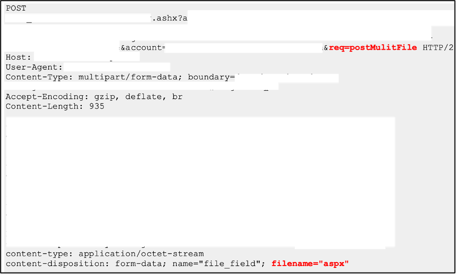

One such chain of vulnerabilities was found in a mobile application for an energy company. The tester discovered a function that allowed the upload of files with executable extensions and content such as Active Server Page Extended files (ASPX) or Windows Executable (EXE) files. The tester bypassed typical checks by using only the file extension (e.g. “aspx”) as the submitted file name, showing the typical ingenuity of our testers.
Successful upload of an ASPX file, which was not intended to be permitted.

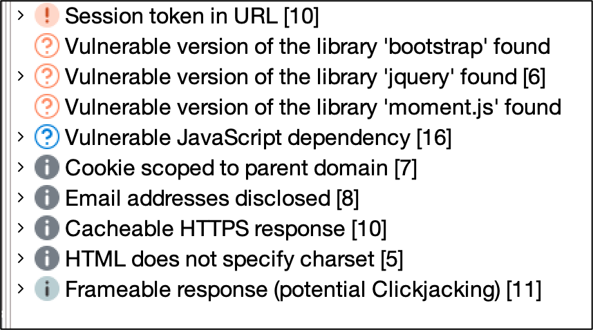

Application vulnerability scanners may have missed this vulnerability due to the unique test case needed to discover this vulnerability. Typically, application vulnerability scanners would test for file upload vulnerabilities in the submitted file name by observing the response from the application from a submission of both the base name of the file (e.g. “file1”) and the file extension (e.g. “aspx”). The test case of submitting just the file extension of the file is not a typical test case and would generally be missed by most vulnerability scanners.
List of vulnerabilities found by the scanner does not have the above mentioned vulnerability.

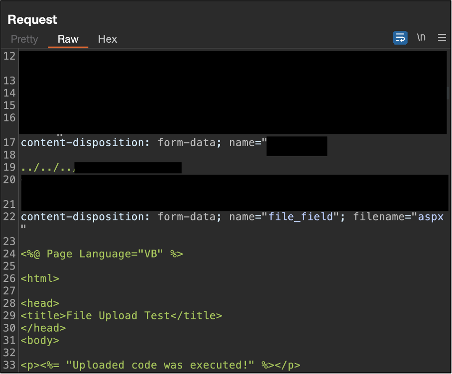

The tester is then chained to this with a path traversal vulnerability to be able to execute code on the running web server. Such a vulnerability would have been missed by a web application vulnerability scanner as well as the vulnerability would only surface by performing multiple steps in a particular sequence – uploading a file, attempting to shift where it was uploaded in the file system and then attempting to access it. Without the contextual understanding through manually testing and exploring the file upload and access functionality, this vulnerability chain would not have been found.
Uploading outside the intended folder could be done through a path traversal vulnerability.

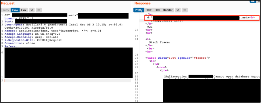

Another example for a client in the automotive sector, found a similar file upload vulnerability. In this case, manual testing found that there was an error message that disclosed more information than required. While automated scans would have treated that issue as a “low” or “informational” severity vulnerability, the tester was able to use the vulnerability to identify the location of where the file was uploaded to by reading the disclosed code, which was within the error message.
Error message discloses the location of a page containing source code.

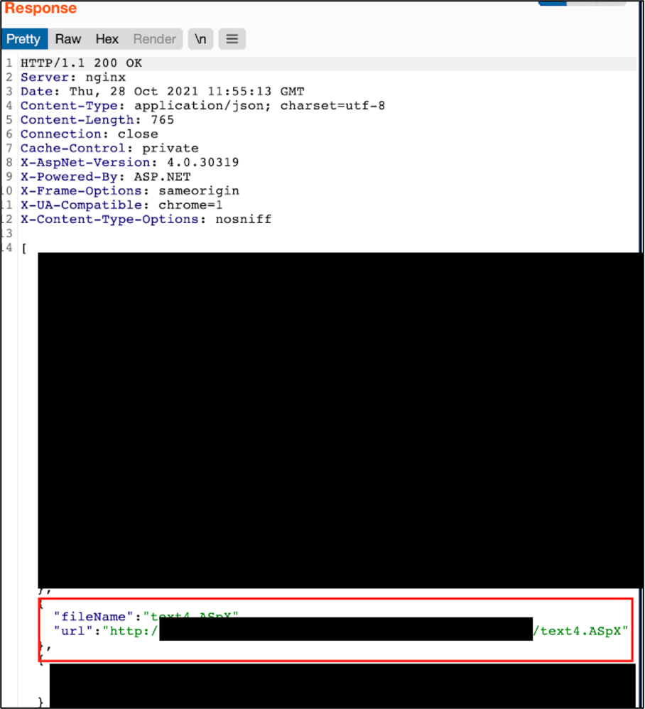

With that information, the tester found a function that he could call, that would eventually disclose the location of the uploaded file. By accessing a crafted file that was uploaded, the tester demonstrated that an attacker could run any code of their choosing.
Location of uploaded file found by using function discovered by accessing disclosed code.

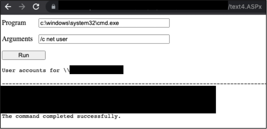

The tester demonstrated that OS (Operating System) commands could be run on the web server.

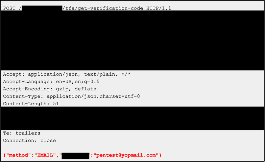

During the test, our tester identified the email field sent during the two-factor authentication process as a vector for account takeover. It was observed during the test that a submitted HTTP request contained an email address parameter (see screenshot below). By design, the email address would be the valid user’s email address. However, the tester observed that changing this email address to his own email address (simulating what an attacker would do) would lead to the application sending the two-factor authentication code to his email address.
2FA (2 Factor Authentication) Verification mechanism made decision based on submitted user email address.
Typical web application vulnerability scanners would be unable to detect this vulnerability due to the need to (1) have access to a working email system and (2) understand the logic of the two-factor authentication mechanism to identify that the email address should not be used or requested at this step. The identification and remediation of this vulnerability reduced the risk of account takeover by removing this vector from the application.
