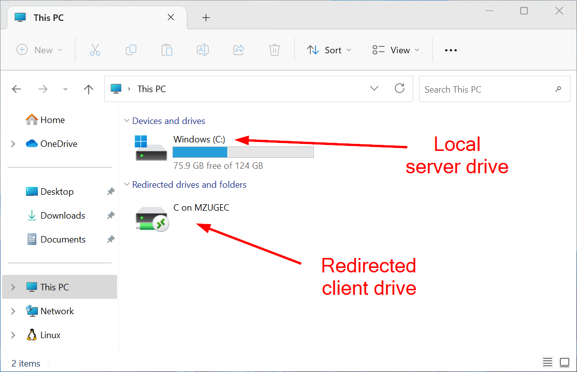

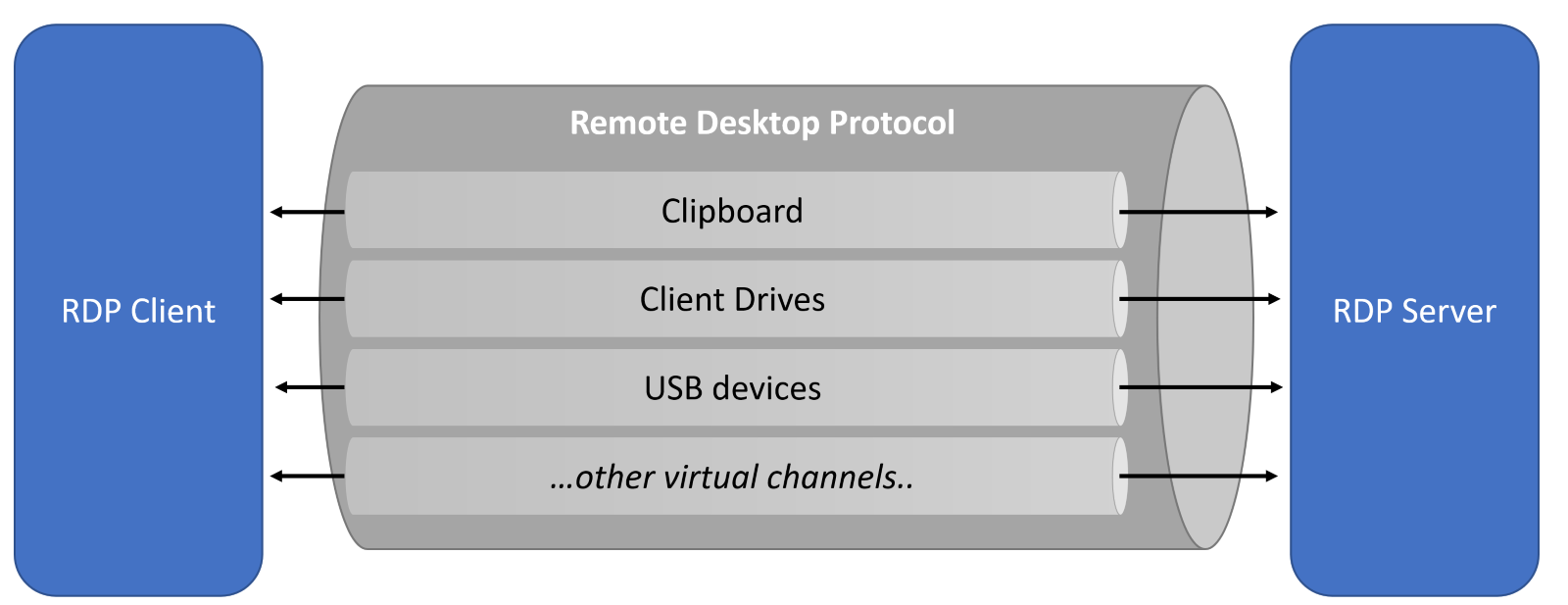

Client Drive Mapping (CDM) is one of the virtual channels implemented as part of the RDP protocol that allows the transfer of data between the RDP client and RDP server (other examples of virtual channels include clipboard or audio redirection).
A screenshot of a remote desktop protocol
Description automatically generated with medium confidenceCDM specifically is responsible for displaying the local drives of the client machine (the computer from which the RDP session is initiated) within the remote desktop session.
A screenshot of a computer

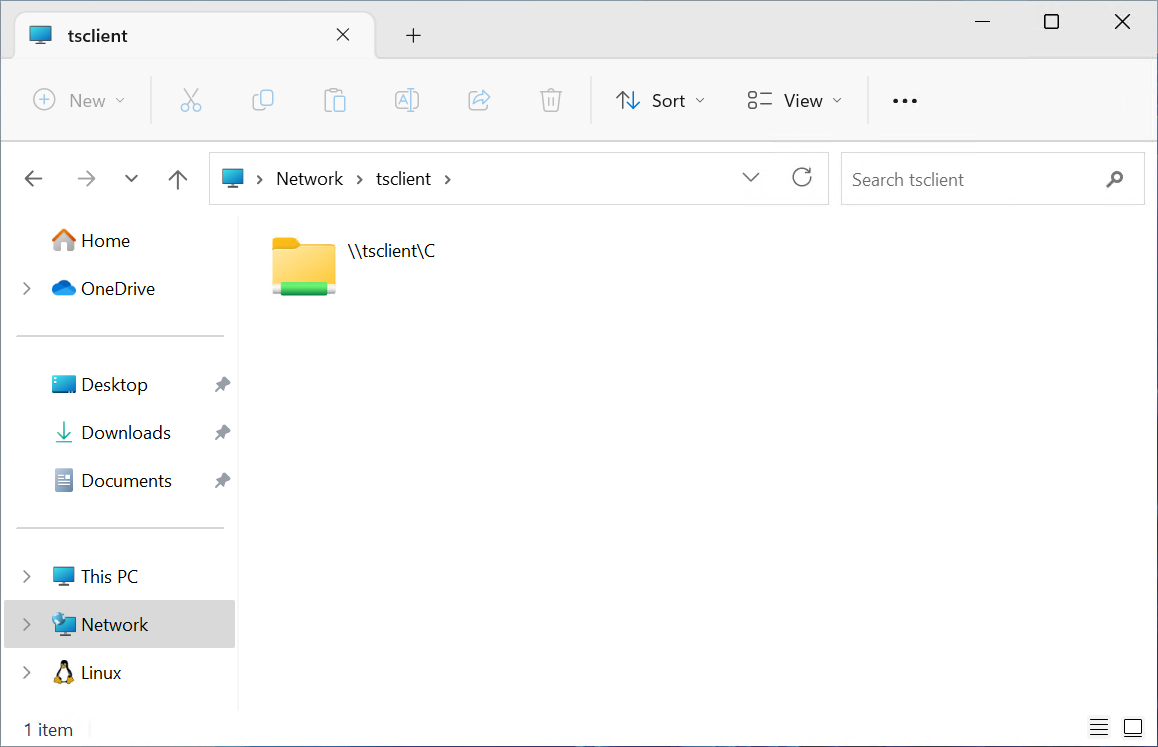

This feature enables users to access and transfer files between their local machine and the remote server or desktop they are connected to via RDP (but also other protocols). This feature is often used by administrators to transfer files between remote server and their admin workstation.
Screens screenshot of a computer

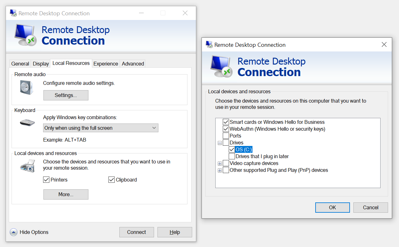

But client drive mapping is also frequently used by regular end users in end-user computing (EUC) environments for both virtual desktops and application virtualization. In the EUC use case, end users typically do not have direct control over this feature, as it is centrally configured through policies. Both the server and the client end must have this feature enabled in order to work, but it is common practice that clients (decentralized) have it permanently enabled, while the configuration is managed solely on the server end (centralized). This is a good reminder that zero trust does not involve only networks or authentication but is a more encompassing principle - servers located on an internal network are not necessarily more trustworthy than clients connecting remotely.
Although we lack specific details regarding the infection vector and cannot definitively confirm whether the compromised system was utilized for administrative access or regular user interactions, it is important to note that this technique is applicable in both scenarios. Furthermore, it is worth mentioning that other solutions employing client drive mapping may also be susceptible to vulnerabilities if they employ tsclient for host-to-client redirection. Even solutions that are not relying on tsclient but use their own implementation of virtual channels can be targeted with minimum code modifications.

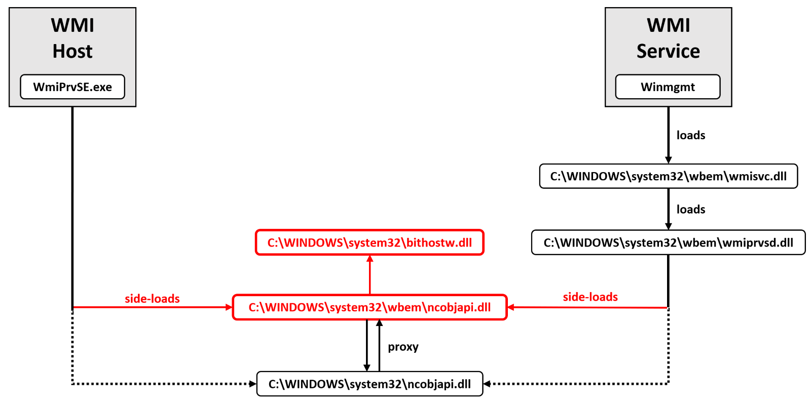

What makes Logutil particularly intriguing is the extent to which it leverages DLL sideloading techniques for evading detection, coupled with its utilization of WMI as a trigger for activation.
We have observed a combination of passive (standalone binaries) and active (pre-installed binaries) DLL sideloading exploits (to understand the difference, read our DLL sideloading explainer). Some samples relied on the more traditional DLL sideloading - a scheduled task launching an executable that loads a library. But the more interesting variant was abusing the Windows Management Instrumentation service (Winmgmt), leading to the execution of malicious binary bithostw.dll (=Logutil).
To achieve this goal, threat actors placed a malicious loader named ncobjapi.dll into a folder %WinDir%\System32\wbem. This malicious implant is mimicking the legitimate ncobjapi.dll library, which is residing in the parent %WinDir%\System32 folder, by exporting the same functions and proxying the calls to the original library. Because \wbem subfolder is checked for the existence of this library before System32, the malicious library is loaded first.
A picture containing text, screenshot, diagram, font
This implant is highly effective to establish persistence on the system. It can be triggered by either WMI service (automatically started with multiple recovery actions), or through WMI host process. There are often multiple instances of WMI host process (WmiPrvSE.exe) running, and there are multiple ways this process is started (including by DCOM interface for remote WMI calls). The ncobjapi.dll library has been previously weaponized by other threat actors like Lazarus group or RadRat operators, but in this case it’s just part of the sideloading chain. The real payload (loaded by ncobjapi.dll loader) is bithostw.dll (Logutil).

While this case is focused on the client drive redirection, all virtual channels are capable of transferring data and can be potentially weaponized. Automated protection controls should be deployed to all potential entry points exposed to threat actors (including work-from-home laptops or roaming employees). This includes next-generation antivirus, but also seamlessly integrated IP/URL/Domain reputation, and protection against previously unknown threats. This gives you the capability to detect and block most security incidents before they can do any harm.
